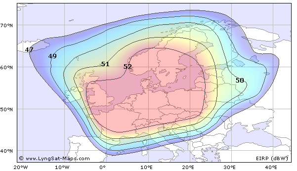

Footprint map according to Lyngsat for these 3 frequencies.

What it is strange is that also the 11758 now reach a little better but sure with level more low respect to Astra 1H. :eusa_think:
I believe that the three frequencies are still on Astra 1F and that they have been moved on the same one beam of the 11758
from beam 1F H+ BSS to beam 1F H- BSS.
Astra 1H is sure more powerful.
Regards.;)

Interesting indeed. So 11758H was not everywhere in the Mediterrenean the weakest of the 4 frequencies which seemed to me up to now. A change from 1F H+ BSS to 1F H- BSS may be the explanation of the latest behaviour. In Greece you now see in the North similar conditions to central Italy before and in the South no change at all. It's like cut with a knife. Extremely narrow these 1F beams :(
