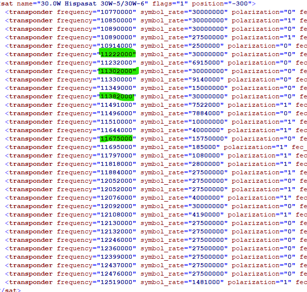

Ho inserito questi txp vado a fare un controllo non avendo il satellite puntato mi affido a SatBeams e similari dimmi quali ti mancano di Albertis e vedrò di aggiungerli
Mi ci vuole un poco, devo fare un controllo incrociato. Grazie per la gentilezza!
se utile...
Codice:
<sat name="30.0W Hispasat 30W-5/30W-6" flags="1" position="-300">
<transponder frequency="10770000" symbol_rate="30000000" polarization="0" fec_inner="4" system="1" modulation="2"/>
<transponder frequency="10850000" symbol_rate="30000000" polarization="1" fec_inner="2" system="1" modulation="4"/>
<transponder frequency="10890000" symbol_rate="30000000" polarization="0" fec_inner="3" system="1" modulation="2"/>
<transponder frequency="10890000" symbol_rate="27500000" polarization="1" fec_inner="3" system="0" modulation="1"/>
<transponder frequency="10914000" symbol_rate="2500000" polarization="0" fec_inner="9" system="1" modulation="1"/>
<transponder frequency="11222000" symbol_rate="30000000" polarization="0" fec_inner="3" system="1" modulation="2"/>
<transponder frequency="11302000" symbol_rate="30000000" polarization="0" fec_inner="3" system="1" modulation="2"/>
<transponder frequency="11330000" symbol_rate="9140000" polarization="0" fec_inner="3" system="1" modulation="2" is_id="1" pls_mode="1" pls_code="174526"/>
<transponder frequency="11347000" symbol_rate="20858000" polarization="0" fec_inner="3" system="1" modulation="2"/>
<transponder frequency="11382000" symbol_rate="30000000" polarization="0" fec_inner="3" system="1" modulation="2"/>
<transponder frequency="11491000" symbol_rate="7522000" polarization="1" fec_inner="6" system="1" modulation="2" is_id="1" pls_mode="1" pls_code="79463"/>
<transponder frequency="11496000" symbol_rate="7884000" polarization="0" fec_inner="6" system="1" modulation="2" is_id="1" pls_mode="1" pls_code="25613"/>
<transponder frequency="11510000" symbol_rate="10000000" polarization="1" fec_inner="3" system="0" modulation="1"/>
<transponder frequency="11644000" symbol_rate="4000000" polarization="1" fec_inner="2" system="0" modulation="1"/>
<transponder frequency="11653000" symbol_rate="19680000" polarization="0" fec_inner="3" system="1" modulation="2"/>
<transponder frequency="11675000" symbol_rate="15750000" polarization="0" fec_inner="3" system="1" modulation="2"/>
<transponder frequency="11695000" symbol_rate="185000" polarization="1" fec_inner="3" system="0" modulation="1"/>
<transponder frequency="12076000" symbol_rate="4000000" polarization="1" fec_inner="4" system="1" modulation="1"/>
<transponder frequency="12130000" symbol_rate="27500000" polarization="0" fec_inner="3" system="1" modulation="2"/>
<transponder frequency="12246000" symbol_rate="27500000" polarization="0" fec_inner="3" system="1" modulation="2"/>
<transponder frequency="12360000" symbol_rate="27500000" polarization="0" fec_inner="3" system="1" modulation="2"/>
<transponder frequency="12399000" symbol_rate="27500000" polarization="0" fec_inner="3" system="1" modulation="2"/>
<transponder frequency="12437000" symbol_rate="27500000" polarization="0" fec_inner="3" system="1" modulation="2"/>
<transponder frequency="12476000" symbol_rate="27500000" polarization="0" fec_inner="3" system="1" modulation="2"/>
<transponder frequency="12519000" symbol_rate="1481000" polarization="1" fec_inner="3" system="0" modulation="1"/>
<transponder frequency="12548000" symbol_rate="29600000" polarization="1" fec_inner="3" system="1" modulation="2"/>
<transponder frequency="12631000" symbol_rate="30000000" polarization="1" fec_inner="3" system="1" modulation="2"/>
<transponder frequency="12671000" symbol_rate="30000000" polarization="1" fec_inner="3" system="1" modulation="2"/>
</sat>
aggiunti
Codice:
rimossi

https://flysat.com/public/en/satellite/position/30-w

grazie @Bobbys avevo visto 12631 e 12671 su flysat, invece non sono molto convinto dei pls ma li lascio non avendo controprova, sto modificando ...lavori in corso...aggiungendo onid tsid e provider... un lavorone... intanto se verificate grazie
Purtroppo ho problemi di allineamento dell'antenna. Comunque 11330 (Aragon SD e HD) che era presente nella tua lista, mancava su un'altra .
Poi penso che 11347 (Abertis DTT) su Octagon necessiti di caricare un file Astra per proseguire.
