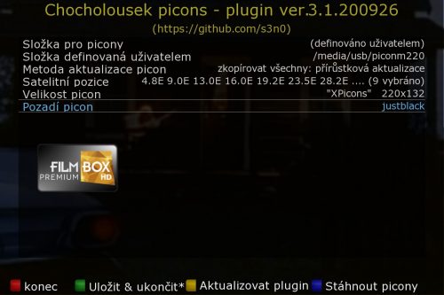

just_black
- Expansion of plagins with a new Just Black background in png32 design, size 220x132.

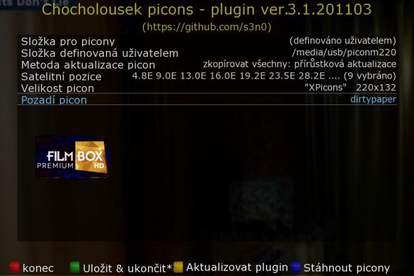

Update file ID today + preview picons!
extension of the plugin with new picons Dirty Paper in png32 design, size 220x132.
dirtypaper-220x132
In the last round of voting on picon.cz won picons Dirty Paper, and could be added to picon.cz and to the plagin Chocholousek picons. :P

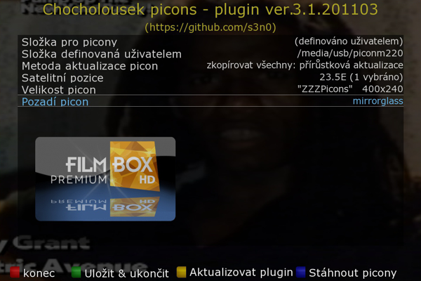

Today released an update of the ID file + preview picons, plugin Picons Chocholousek updater!
- extension of the plugin with new picons Mirror Glass in png8 design with a size of 400x240
