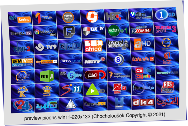

On 22.10.2021 an update to the file ID + preview picons, plugin Picons Chocholousek updater!
- the plugin is extended by new picons WIN 11 in png8 design with size 220x132.
